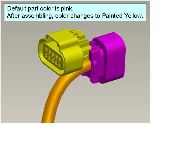

I'm facing a problem with the component color while working in WF5.
When ever I assemble a component/part, it appears in different color rather than the default component color.
Are there any settings in WF5 to obtain the component default color.
Please help me out.

Hi Jayant
I am not quite sure about the problem
But what I suggest you to
Go to Appearance gallery
&gt Clear Appearances
and apply to the assembly
One of the reason why parts change to a specific color might be :- You have applied color to the assembly or Your Default assembly template
Hope This will solve your problem

Hi Kshetrabasi Mananta,
Thanks for your reply.
I have tried this option earlier itself, but i did not acheive the needful results.
So can you please help me out for other means to sort out this problem?

If you are talking about during the process of specifying constraints check the setting for the config.pro option preserve_comp_color_in_preview.

Hi Kevin,
I thought it would be helpful.
My default config settings were set to "NO".
Now I changed them to "YES" and tried to assemble the part.
But also couldn't achieve the desired result.
Here is the snap shot of my results...
Please let me know if there is any other options...
Jay

Are your parts made from quilts that are copied from a master file, using Copy Geometry, or just Ctrl C-V ?
Because if the quilts in the master are assigned separate colors the colors will propagate through the child parts. Which is annoying.
