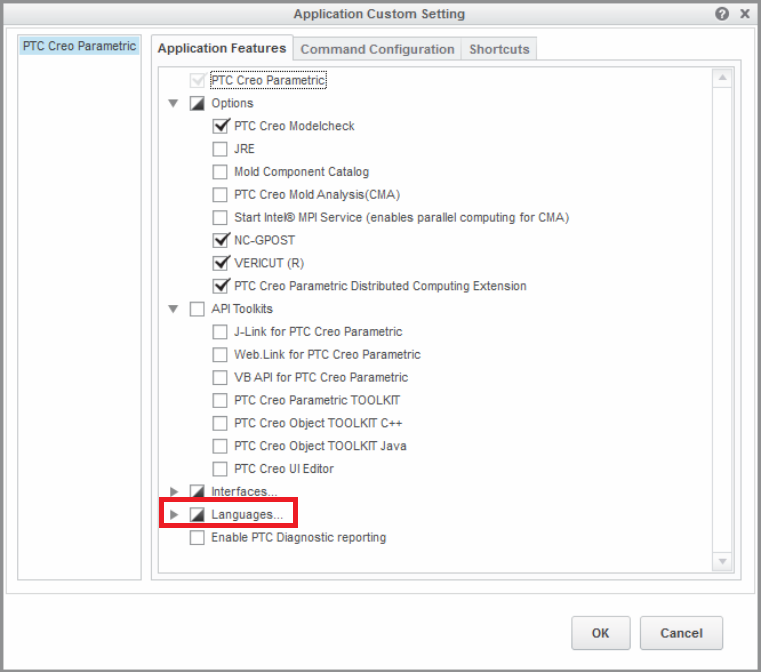

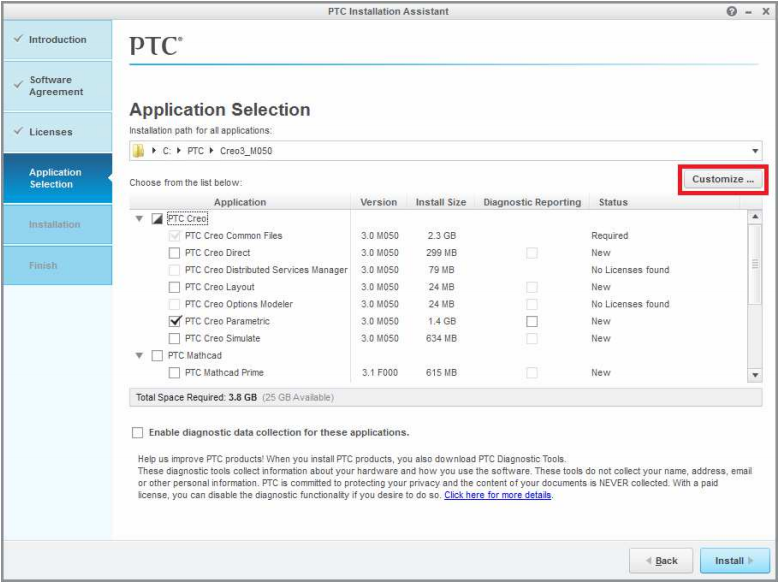

1.)
To select language during installation, you have to click Customize button and then set options in Languages group.
