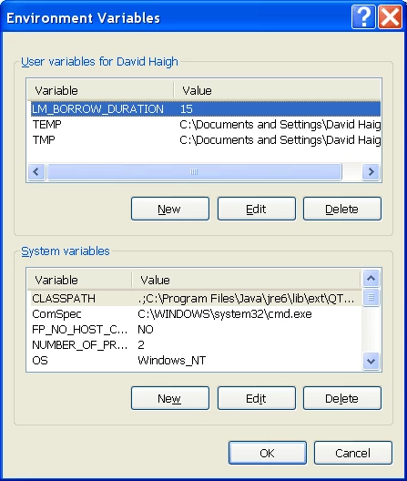

October 4, 2011
Actually it’s 14 days plus the current day, so 15.
On the laptop go to Control Panel -> System.
Under the Advanced tab, click Environmental Variables.
Create a new variable with the name LM_BORROW_DURATION, and the Value of 14.
Another item that’s covered in my ProE Admin 101 talk.
