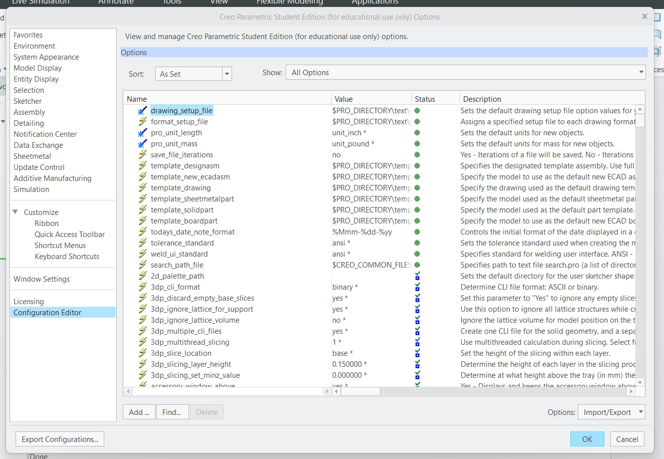

Changed config ‘save_file_iterations” to “no” but still saves multiple files.
Wanted to turn off the save_file_iterations feature and so I followed the recommended steps by going into the configuration editor and changing it no. Now when I open a creo file and check the configuration editor, it still says the save file iterations is turned off but when I save, it continues to save multiple files. It’s as if it’s not listening to it’s on configuration or something is overriding it…

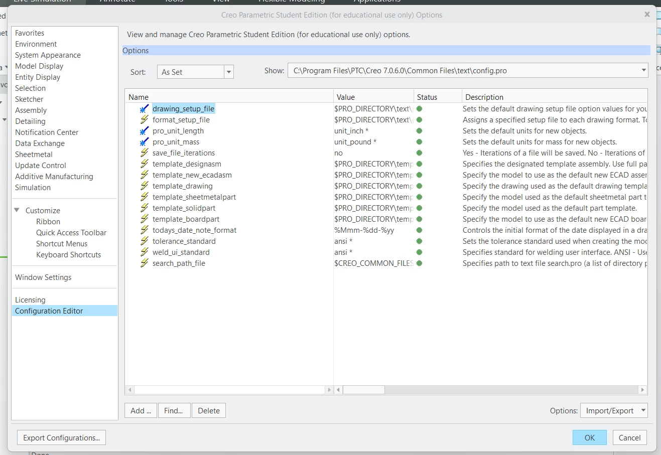

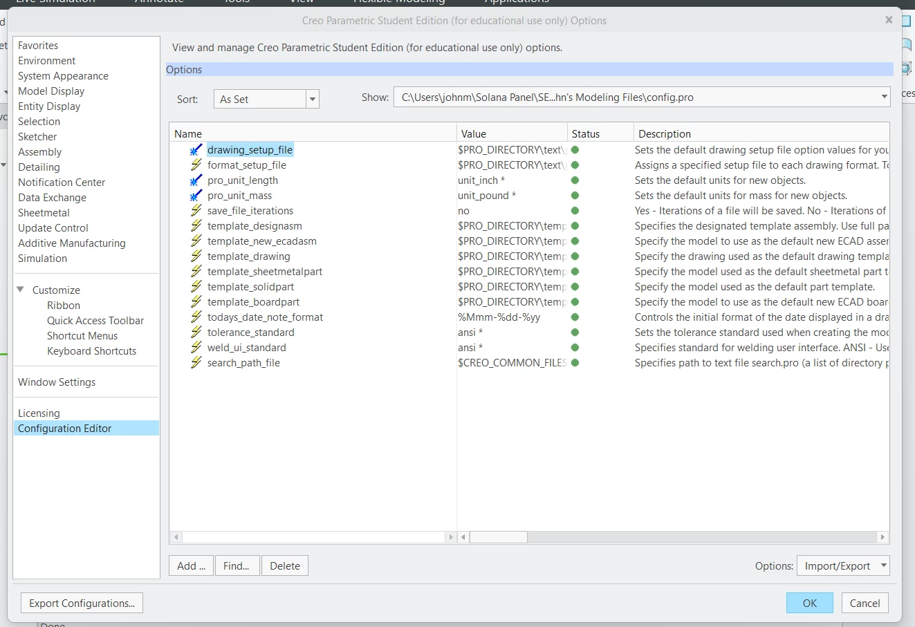

There are 4 config files that Creo can load when started.
Last file opened wins unless the config option has been set in the config.sup file.
Open Creo and then look at the configuration options. the list will be in last loaded on top. Check all 4 files to see if this option has been set in another file, or your file is not being loaded.

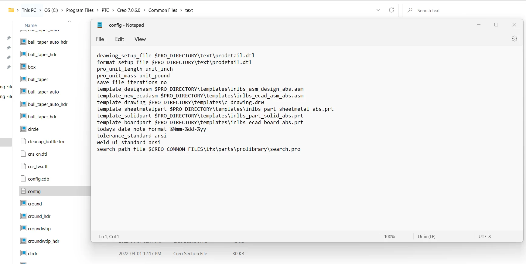

Apr 7, 2022 1:49 PM UTC
Yea so i just checked all of them and they all say that it is set to no. I even went into the config.pro file and changed the text to include "save_file_iterations no". Still doesn't seem to work. I don't know where it can be pulling this default setting from...

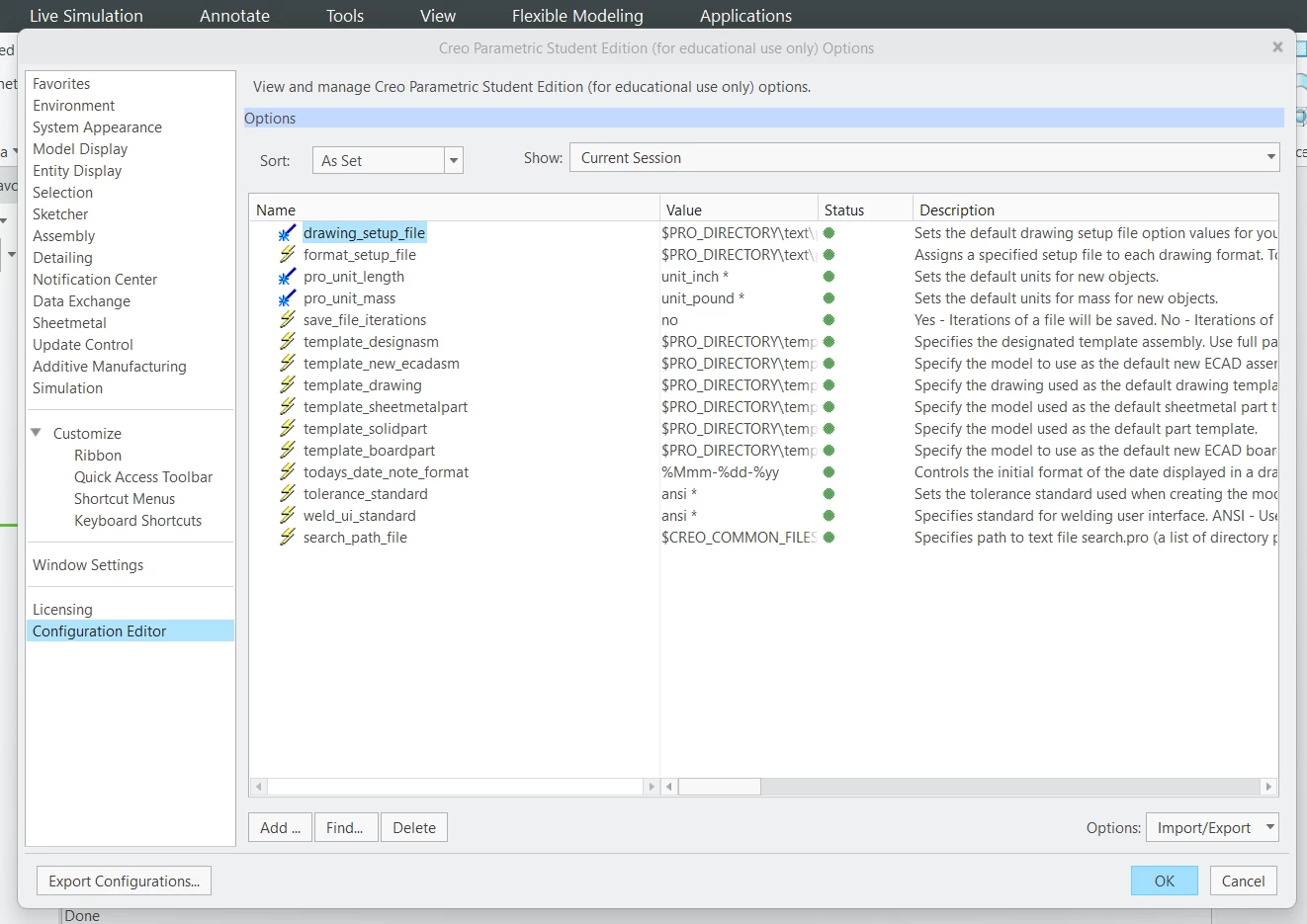

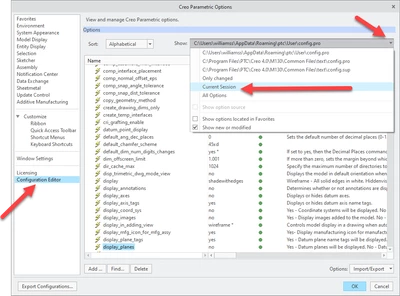

Apr 7, 2022 1:33 PM UTC
Double check your config settings by going to FILE - OPTIONS - CONFIGURATION EDITOR.
Select the drop down arrow on the list and select "current session"
Find the option and make sure it is set as you want. If it is not, then you may have more than one setting in your config files.
You can also review all your config files using the same drop down arrow!
