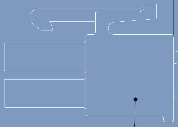

I am producing drawings in Pro E WF 5 and when saving them as PDFs the line thickness becomes too much.
I've touched upon some info regarding the different pen weights, but am not familiar with altering the config settings. Perhaps someone is willing to share some light on the subject.
Mike.

It's the model line thicknesses that are too heavy, thanks though Mike.
May 29, 2012
No problem. Are you talking about the line weight from a 2d view? Like attached?

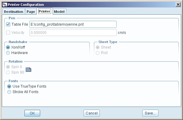

you have to change your pen table file (*.pnt) in order to set the thickness of printed lines.
You can search for "pen table file" in the help center.
If you use a pdf printer (like pdf creator or cutepdf writer ), this file have to be choosed in the printer configuration.
If you export your drawing as PDF file, you have to set "Use pentable" in the PDF export settings and you have to have a file called table.pnt in your working directory (unless you are using the config.pro option pen_table_file).

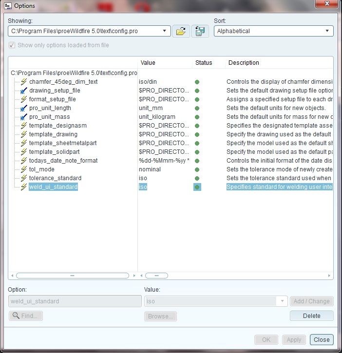

can u pls explain, how to create a new pen_table_file and edit to various pen values you mentoned above.. i can't able to create that..
i followed the steps Tools- options,my window looks like below
but i can't found pen_table_file on that window, pls guide me how to move further to create a new pen_table_file and edit the values..4.jpg
August 20, 2013
You need to "find" the entry in the config editor.
