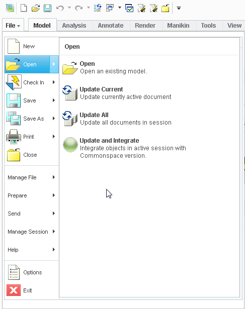

My company recently disabled/removed the Checkout and Revise buttons from File>Open and the RMB popup window due to unintended revisions. It is possible, but I have no idea how it was done. It's probably an admin setting.
Interestingly, the Checkout and Revise option in the conflict resolution window is still available. I wonder if that was an oversight or if that can't actually be removed.

I did some digging and it looks like this was acomplished through Jlink. A custom toolkit utility was written to hide the Revise and Checkout buttons.
