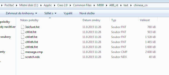

Jul 12, 2016 11:32 AM UTC
Ok. I have never tried to modify the proe fonts. I've only ever bothered with TTF fonts, but I guess copying just the *.ndx file won't do it.
*.ndx files go to dir
<Creo_Install_Dir>\Common Files\MXXX\text\usascii
if you open any of these *.ndx files in plain text editor such as notepad they contain names of font files with the *.fnt extension. Those files belong to dir
<Creo_Install_Dir>\Common Files\MXXX\<machine_type>\text\usascii or <Creo_Install_Dir>\Common Files\MXXX\<machine_type>\chinese_cn for that matter
Do you have the chfnt.fnt file in there? See the picture bellow.
