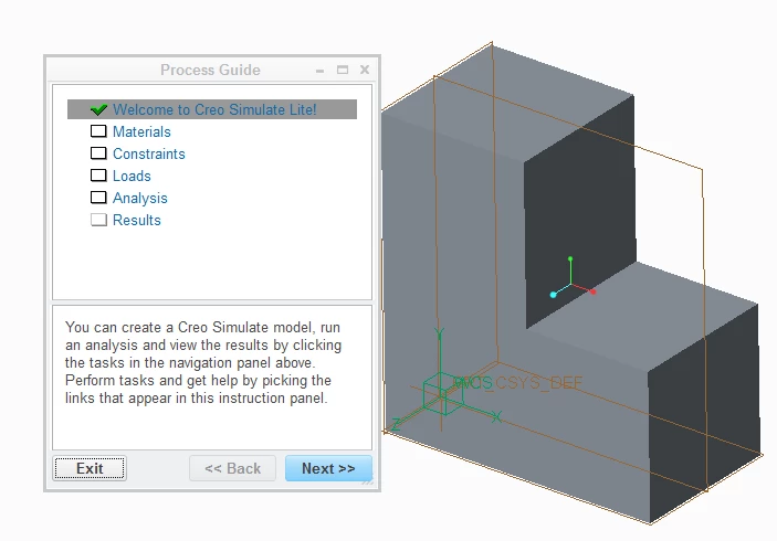

I just installed student license of Creo 3.
I create a model.
Go to Applications>Simulateto set up a linear static FEA
and I am presented with a Process Guide wizzard that I don't want to see.
If I click Exit I am knocked out of Simulation environment.
I don't get this screen on the school lab computers - how do I get rid of it?

This usually starts automatically with Simulate Lite, a free version of Simulate that is very limited. Do you have a license for Creo Simulate?

sorry for replying to this old post, but it is the only thing i could find with my same issue. I also just installed the latest student version of Creo and i am having this issue. I am following a text book to do homework but i can not get past this process guide screen. is there a way to bypass this?
May 2, 2017
as far as I know Student license does not contain full license of Creo Simulate. Only Creo Simulate Lite (available for free) can be used.
