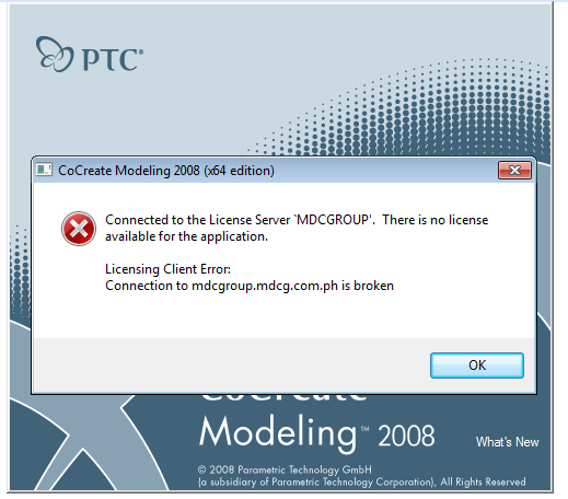

I have a problem installing cocreate 2008, After the Installation I got this error

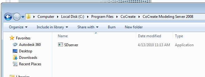

When I look the cocreate folder in my program file I only see this.
When I run the application it just run a command prompt.

It looks like the first issue is that you may need to install the License Server, not just the Modeling server. When you install the License Server, it will ask you about the license file and things like that. Have you installed that and configured it?

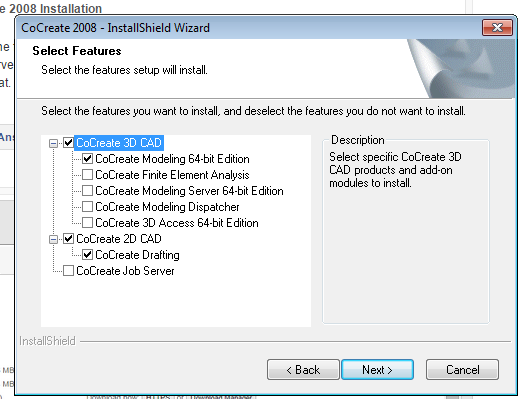

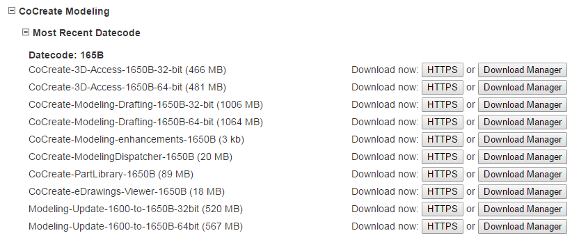

Thansk for the reply. Where to find the License Server? It is not include in the download section in PTC
May I know which of this installer has the license server?
Because when I install the modeling and drafting I only see modeling server. Thats why I check the modeling server during the installation.

I just sent you a private message to see if we can figure out what's going on. Strange that it's not in the list there...
We'll see what we can do!
