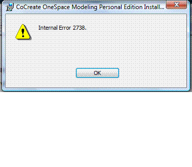

Dear Forum Members, I have downlaoded CoCreate OneSpace PE free Edition a few days back and ever since then, when I try to Install it an error message is generated saying "Internal Error 2738" and then Installation is stoped. (Copy of Error message is attached as a GIF file for your perusal). I am using Windows Vista. Request help. Regards Zubair

The answer to your question is posted in this forum, and is set as a sticky. I will re-post the answer for you here.
anonymous wrote:
Solution Windows Vista doesn't always register the VBScript run-time interface. At first find out where vbscript.dll is. The typical location is in C:\Windows\System32. Next you need to go to Start > All Programs > Accessories and then right click on Command Prompt and select the menu "Run as administrator". In the command prompt self enter following commands: $ cd C:\Windows\System32 $ regsvr32 vbscript.dll The command regsrv32 should confirm that the VBScript has been registered. After successful completion of this action, the installation should work.

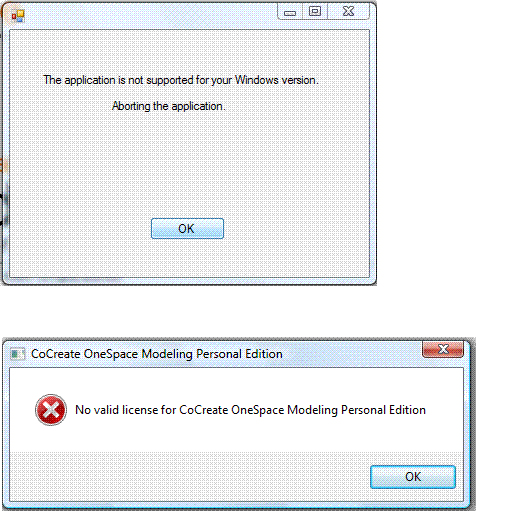

Dear Richard, I am extremely grateful for your reply and help. Cocreate PE was installed after following your instructions, however after installation 2 more under mentioned errors were generated when Cocreate was launched; 1. The application is not supported for your Window version. (I am using Windows Vista) (copy of error message is attached as GIF file) after clicking OK under given message appeared 2. No valid License for CoCreate OneSpace Modeling PE Edition. (copy attached as GIF file). Can you kindly advice. Regards Zubair
