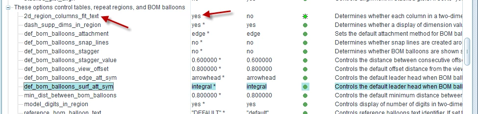

I seem to remember there is a config/dtl setting that allows to have different width columns in a 2d repeat region?
When showing a 2d repeat region on drawing (instances and items driving a family table) by default all columns have the same width
This most of the time cost more drawing space and results in almost empty cell.
I recall being able to change the width to the minimum necessary per column
But there was a setting involved, I don't recall which though
Anyone ?
March 11, 2014
Hi Liek,
Here is the drawing dtl setting. This setting is "no" as the default.
