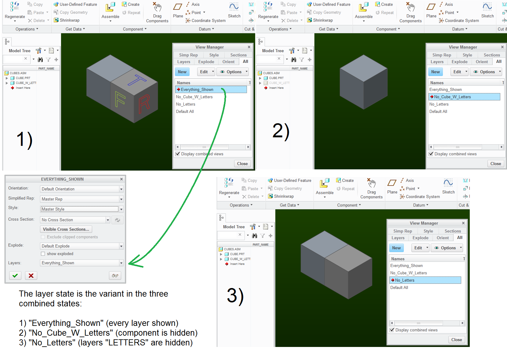

Can you please share a screen capture from the view manager 'ALL' tab? This will show us what combined views you have created and give us a clue how you are working. What are the names of the combined states that you want to use?

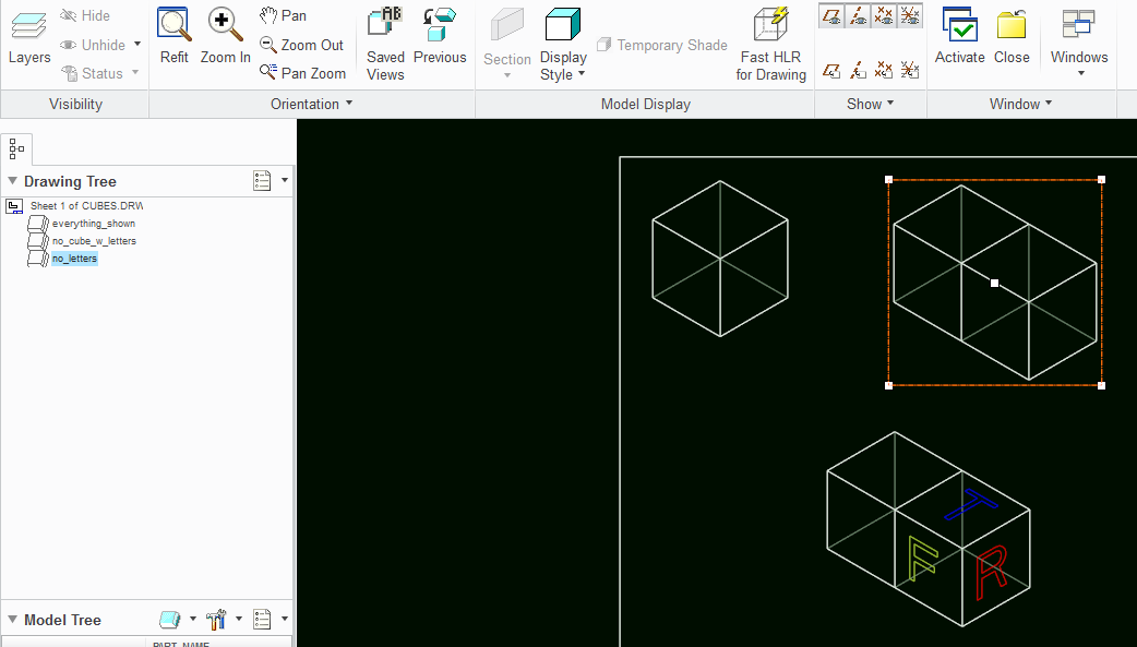

Ok, I took some screenshots to explain what is happening to me.
1) Essentially, I'm using different layer states as a way to control the visibility of features and components in an assembly:

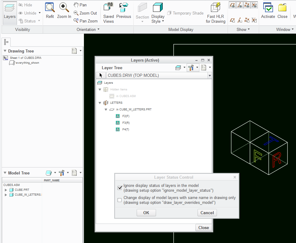

2) I create a drawing of this assembly; and as I put in the views, I'm prompted for which combined state to use.  So I pick the ones I want:
(here, I also show the Layer Status Control setting for the drawing)
So I complete placing all 3 views, and everything looks as though it's working as expected, so I save this drawing:
(also note I didn't fail to save the layer status in the drawing)

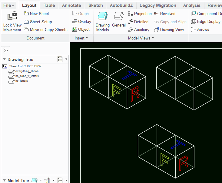

3) But then, when I close the session and open the drawing, this (unexpected?) result:
This definitely has something to do with hidden components not staying "hidden".  In general, I think this combined states thing in Creo is at worst rather ridden with bugs, or at best poorly described in the help documentation and I just don't have the magic decoder ring.  But for me things are just not working consistently in neither assemblies nor drawings and each new session is a mystery.  I'm talking about the items that are supposed to show up for a given combined state (e.g. "everything_shown") are staying hidden and it takes some kind of a combination of clicking on the combined state tabs in the model to get them to "reappear".
For time being, using layer states seems to work if you wish to hide features, but if you need to hide components, then make a simplified rep in which they're excluded.

Since parts are disappearing in views they shouldn't check the Drawing Layer Status, the first option should be checked. For the config option all it seems to do is control whether or not a combined state is asked for when creating a view.
