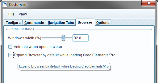

Actually, I was wrong there. That option hides the 3D model space tab. The correct answer is in Tools > Customize Screen > Browser, then uncheck "Expand Browser by default..."
