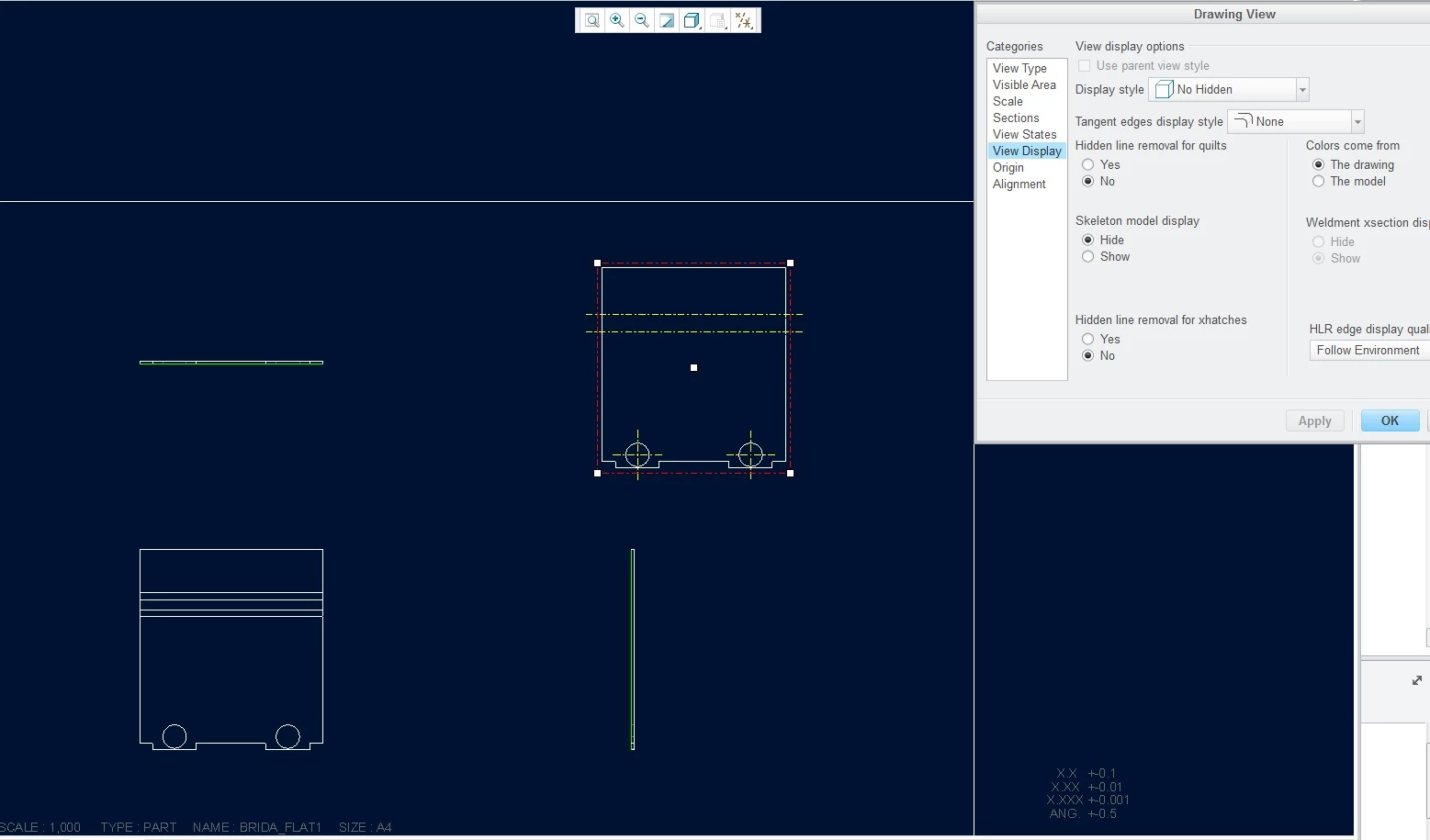

hello
i need a option
i want to set all time as default like untiled.jpg whithout (hidden and any tipe of lines )
and i want to show alll time bend lines and axis
what i set for this
it is posible>?

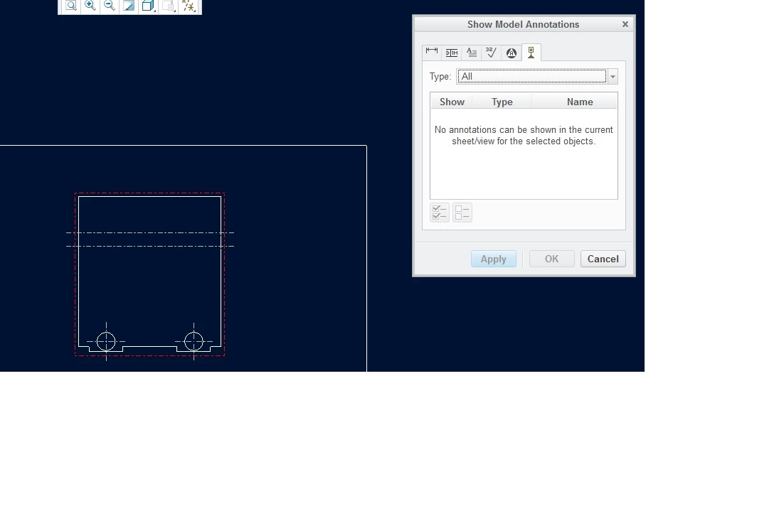

a) you can make it so your drawing template has this drawing setup option set:
model_display_for_new_views no_hidden
b) in order to display the bend lines - I use the annotate/show model items function and then show axes in a particular view...
I don't know of a way for axes to be show as soon as you create a new view...
