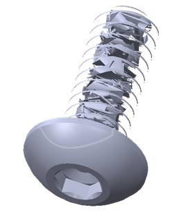

  3. If you have imports, make sure you don't have imports that look like this:
