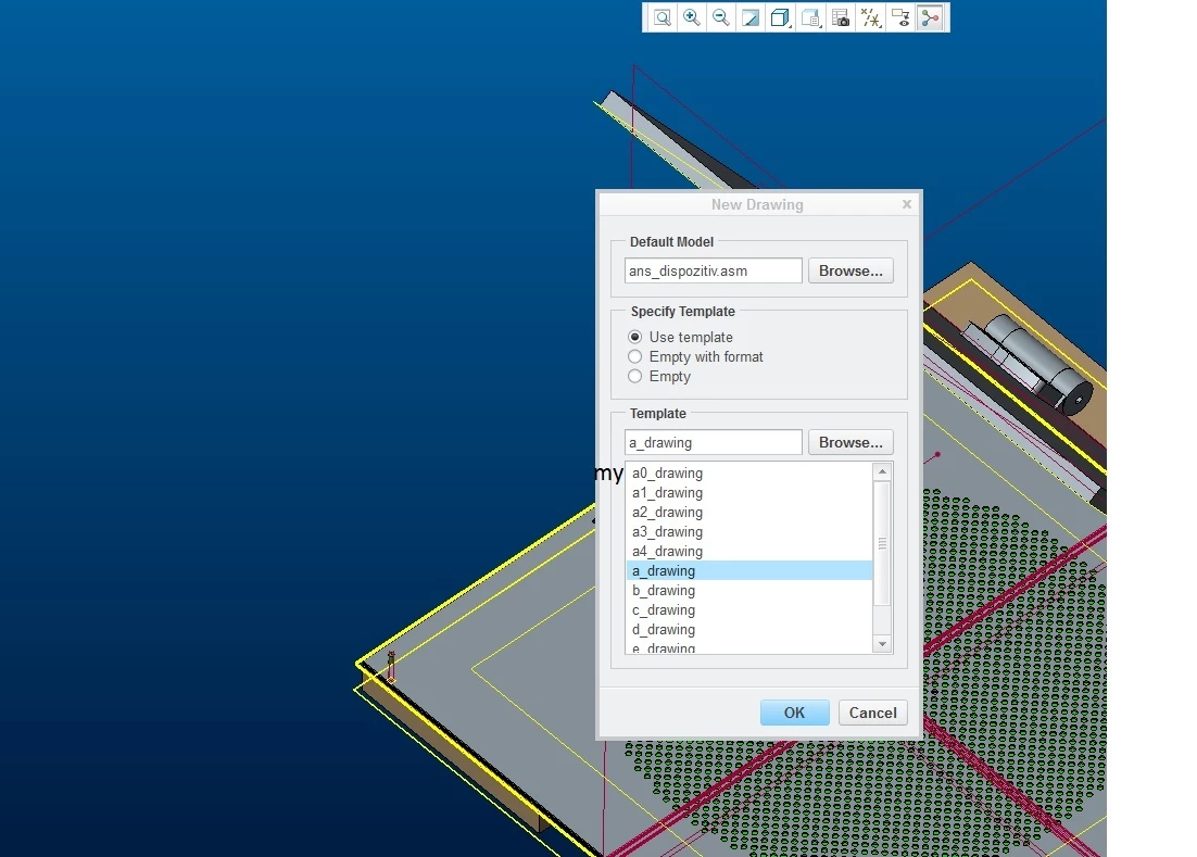

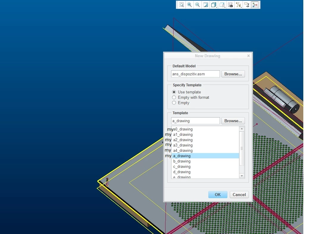

I have a problem , i want to modify path of my templates
when i create a new drawing creo goes on standard templates
How set path to my template if i have on desktop config.pro?
I want when i create a new drawing creo goes on my templates
In picture before i put what i want creo to display me
TKS

did you tried following config.pro options?
TEMPLATE_DRAWING
START_MODEL_DIR
Also, you can go to ...\Creo 2.0\Common Files\M070\templates directory, move system drawing templates somewhere else and place your templates there.
MH
June 10, 2016
Also try pro_format_dir.
June 10, 2016
There are a number of config options that control default locations. SOme point to specific files, others to a folder containing the files:
bom_format - text file for the internal BOM function (model tab in assy mode)
drawing_setup_file - default drawing setup file
mdl_tree_cfg_file - model tree config file
pro_colormap_path - folder containing color map files
pro_dtl_setup_dir - folder for drawing setup files
pro_format_dir - folder for drawing formats
pro_group_dir - folder for user defined feature files
pro_library_dir - folder for the standard parts library
pro_material_dir - folder for material files
pro_note_dir - folder for standard drawing notes
pro_sheet_met_dir - folder for sheet metal bend tables
pro_symbol_dir - folder for drawing symbols
start_model_dir - folder for model templates or "start parts"
template_designasm - default assy template
template_sheetmetalpart - default sheet metal part template
template_solidpart - default part template
There isn't one, oddly, for drawing templates.  There is for formats, but not for templates.  I believe it defaults to the specification for start_model_dir.
