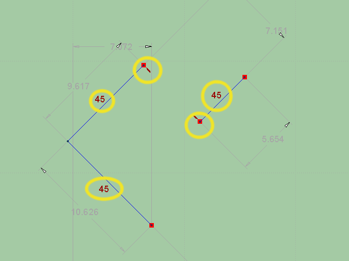

How do you enact the "diagonal" constraints? I managed these to show up during the creation of the lines - note I had to use the "sketcher_diagonal_constr yes" config.pro option.
But how do you impose them after the entities are already created in the sketcher?
March 23, 2015
Interesting find. It only recognizes 45 degree relations.
I find it odd that file>options>sketcher doesn't list this in the constraint assumption section even when enabled in config.pro.
