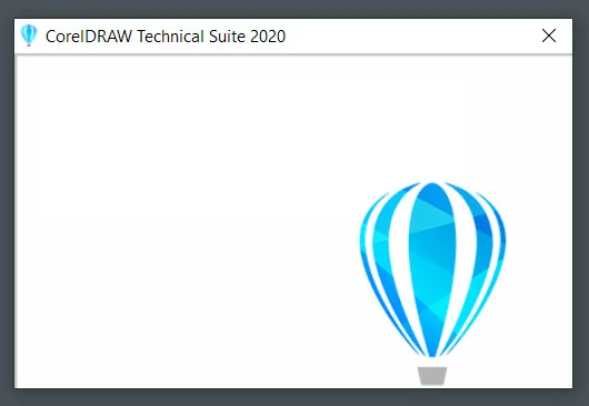

Hi alls,
I can't install Corel Draw (2020 - 2021) nor Corel Technical 2020 on Windows 10 when Creo2 & Creo7 are installed.
I've noted this on 2 computers.
On one of them, I've got a second win10 (dual boot) without PTC software and I can install Corel without problem.
Very strange but it's the only difference.
Instead of normal Corel installer Window, I get image attached and nothing happen.
Does someone knows if there is any compatibility problem with Corel installer ?
Any advice ?

in 2018 I used information available on https://community.coreldraw.com/talk/coreldraw_graphics_suite_x8/f/coreldraw-graphics-suite-x8/52729/unable-to-install-coreldraw-graphics-suite-x8 page.
  • In security settings of INTERNET OPTIONS push "reset all zones to default level"
  • do not launch DVD_Corel\CorelLauncher.exe
  • in DVD_Corel\x86 directory ... make a copy of Setup.exe named MySetup.exe
  • launch MySetup.exe
