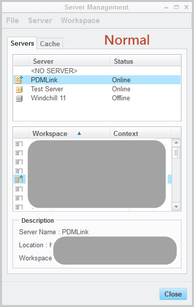

I'm trying to roll out corporate wide mapkeys that will supersede users mapkeys if they have the same name to avoid users calling and saying the standard mapkeys aren't working (similar to to config.sup vs .pro but that discussion is closed and written in 2012). We're using Creo 3 M060.
I've created a trail file that for opening Creo and setting the mapkey.pro file I created and have attached it to the icon. After clicking on the icon... Creo opens, mapkeys load fine but it disconnects all the Windchill servers. Normally when starting Creo at our company, Creo prompts users to sign into Windchill (I think b/c our start parts in our config.pro are in Windchill). This Windchill sign-in menu selection doesn't appear in the trail file so I can't have the trail file click ok. The servers are just missing not just 'working offline'. Removing the trail file from the Creo start icon brings the servers right back.
I've tried using long (full start up sequence with loading mapkey.pro) and short (only load mapkey.pro steps) trail files.
Is there a way around this? Or a different method for superseding users mapkeys? I could make a mapkey called 'load' for users but that doesn't work great with the creo_parametric_admin_customization.ui mapkey menu I made on a separate tab and requires users to remember to type 'load'. The config.sup unfortunately isn't a good option for mapkeys (I wish it was) because then users can't create their own mapkeys.
