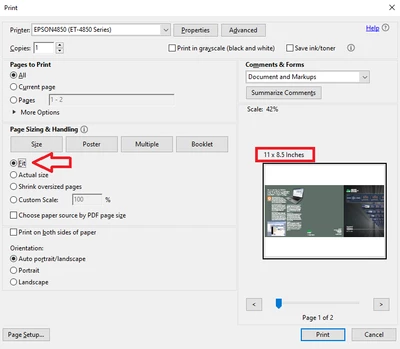

I would like to create a PDF which contains a drawing in format 8-1/2 by 11 (A) and a format 11 by 17 (B), in the same drawing.
example: page 1 is of format A and page 2 is of format B.
Except that, when printing if the format A page is first, the second page which is format B will be compressed into format A.
So, is it possible to create a PDF document and have the first page come out in format A and the second page come out in format B.
July 5, 2024
Yes.  Fitting all pages of a PDF to a certain paper size is controlled by the print output settings of the PDF viewer.  It has nothing to do with Creo.
