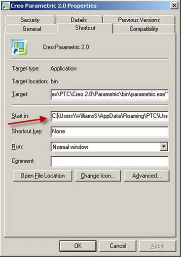

"load point" and "start in" locations are two separate things, correct?
As for contents of the .sup being the same as .pro, I made a different text file with only "accuracy_lower_bound" at a different number to test .sup.
I chunked the .sup file in the "load point," restarted Creo and that setting was niether locked/different from the .pro file when i checked out my current session config settings.  I also tried putting it in my "start in" location and that did not work, either.
edit: added a screenshot file.
StephenW
July 10, 2017
Text folder would more likely be in program files...like this
C:\Program Files\PTC\Creo 3.0\M070\Common Files\text
except the creo 3 and the m070 part
Start in is where you're shortcut "start-in" is, not where the shortcut is actually at. Look at the properties for the shortuct:
