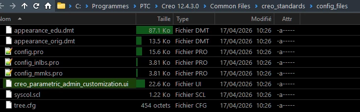

I have a file  creo_parametric_admin_customization.ui from my installation at this location :

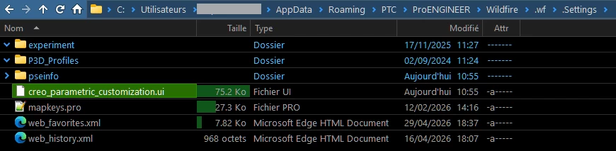

I have my personal file here :

Jun 2, 2026 12:32 PM UTC
Load point would be C:\Program Files\PTC\Creo X.X.XX.X\Common Files\Text (same place config.sup would be)
User UI should be in the “Start In:” location of the shortcut used to launch Creo.

Thanks for your answer. There’s one thing I might not understand.
I have put my creo_parametric_customization.ui that is located in C:\Users\raphael.morin\AppData\Roaming\PTC\ProENGINEER\Wildfire\.wf\.Settings in my starting directory and launched Creo 12, and I still can’t see my customization.
I have set  load_ui_customization_run_dir to yes, i still can’t see my customization.
In fact, I have the feeling that with Creo12, it doesn’t launch anymore from C:\Users\...Roaming\PTC\ProENGINEER\Wildfire\.wf\.Settings
