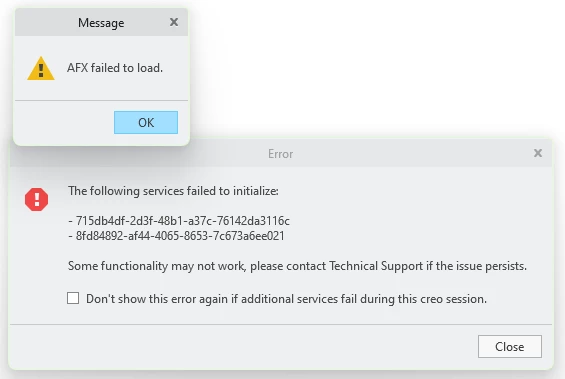

I have installed Creo 12 successfully on 2 machines but on one of the machines I get the errors below and the browser fails to work. Presumably the errors below is because the browser is not working.

remyAnswer
January 13, 2026
the following two articles :
https://www.ptc.com/en/support/article/CS439480?source=search
https://www.ptc.com/en/support/article/CS340693?source=search
suggest there is something to do with access and admin rights

Installing locally as admin fixed the issue

In the past with I think version 4.0, whenever I installed a new release I would always have to start up Creo while still logged in as admin Otherwise, Creo wouldn't actually "finish" the installation. It seemed to always need to do some sort of "first time running" stuff to get things completely configured.
