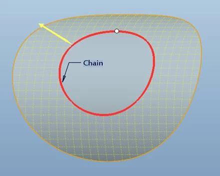

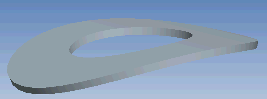

There may be an easier way, but I think I would do this by intersecting a
curved surface with a cylindrical surface then thicken the resulting quilt.

One really simple way is to project a curve of the washer profile onto a curved surface. Then trim the surface using the projected curves. Finally, thicken the surface to the washer thickness. Another option would be to do something in sheet metal.

Investigate "bend solid" it should provide a nice solution.
