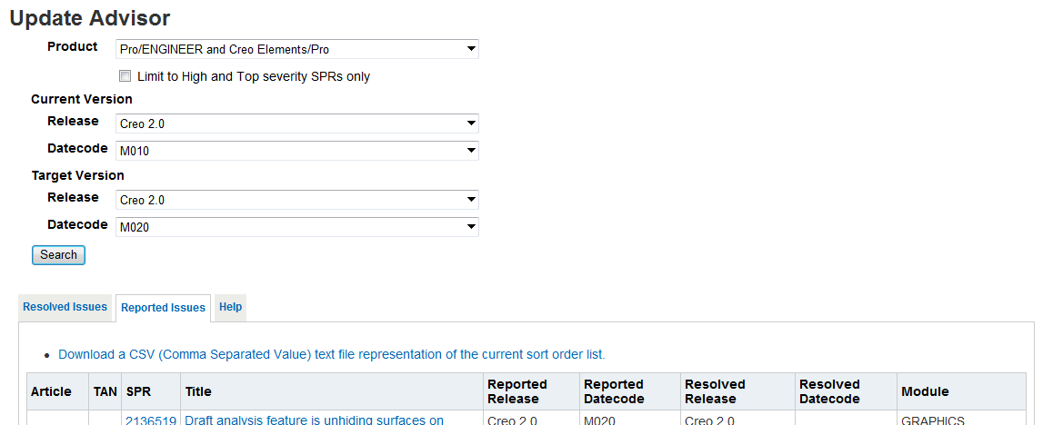

I'll start this with the link to the Update Advisor:
https://www.ptc.com/appserver/cs/update_advisor/update_advisor.jsp
You can plug in your version and the latest released version.
I'm not looking forward to doing the update but I have already downloaded both the files.
I may wait to have support on the phone to see how to properly uninstall the previous version first.
Tell us how your update went, and did you see improvements to your favorite peeve?
You probably need to be current on maintenance to access the Update Advisor.

I think the update advisor is broken or maybe theres no advice when I try to take an advice on going from Creo Parametric 2.0 M010 to Creo Parametric 2.0 M020.

The advisor is working. Probably what is more important is the Reported Issues section.
Both lists are quite extensive. Unfortunately, the information you can gather from the list is still quite criptic but better than nothing.
