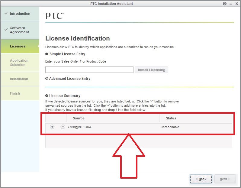

Creo 2.0 M200 - licence Unreachable
Greatings all Creo admins,
got a question for all of you. Got some problem with obtaining licence during Creo install to new workstation.
Description:
- PCs connected via site (don´t know more informations about site )
     - my PC called K620
     - INTEGRA is the PC where licence has been saved (should be like server machine, but it´s regular PC)
- K620 and INTEGRA pings are ok from both sides (see cmd window below)
- Firewall was turned off
- ESET end point antivirus was turned off
INTEGRA PC informations:
- Creo is running corectly ---> flexnet is OK and licence file is OK too
Question:
Something is blocking communications and l don´t know what is it?
Could you give me some tips what to check, please?
l´m solving this problem with local PTC reseller too, but more heads know more...
Wish a beautiful day for all of you...
Regards Milan

February 26, 2016
Are the Firewalls switched off on both computers?
Is the Network card of the Flexnet-computer the 1st card in the row?
(you are able to set the sequence somewhere in Windows. The one with the License MAC-Adress might need to be the 1st)
February 26, 2016
1.]
Please show ping K620
2.]
Is firewall on INTEGRA turned off ?
3.]
What network is used to connect K620 and INTEGRA ?
> local LAN network
> local WiFi network
> Internet + VPN
> something else
MH

Milan,
Did you tried adding IP Address of server in client machine host file?
Check the results of telnet via port 7788 from client machine.

2-Explorer
February 28, 2016
Thanks all of you for your inputs.
Each of you has a part of true... problem was so simple .
Forgot to insert Firewall exceptions on LICENCE machine (INTEGRA).
      A)  port 7788 --- is 100% free in Firewalls
      B) ptc_d.exe --- is 100% free in Firewalls
l have finished my instalation and it´s ok... let´s start some useful work.
Thx onece more again...
