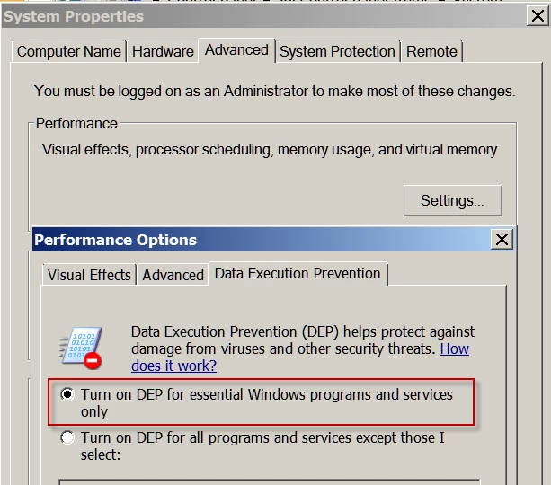

Here's the setting that will either prevent you from installing on a network drive or allow you to install on it.
I would suggest you don't want to leave this set so you can install. You want to only change it when you need to install and then set it back.
Can't install:
[cid:image001.png@01CDD6ED.C1049A70]

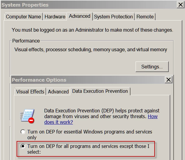

Can install:
[cid:image002.png@01CDD6ED.C1049A70]
