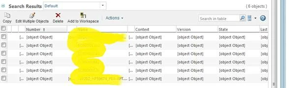

    Mar 19, 2014 3:43 PM UTC
    Doesn't even have anything to do with using the commands and such to what you point out.
    I'm talking about things like many of our users not being able to add files to their workspace. Or revising files. Or even just editing parameters in their workspaces. Each of these gave the user the spinning progress circle and it would never complete. It took about 2 or 3 days for PTC to come up with a Microsoft security update. To be fair though they asked for several logs to analyze which were pretty large. We just installed it on many of our users computers yesterday. I can't confirm yet but I've had 2 or 3 people that have other problems now.
    Then there is the initial go-live date where either in a search results table or even in the workspace it wouldn't show the File Name, Number and several other pieces of meta-data. It would only display the text "object Object". Had to clear the server side java cache AND then the user had to refresh the page. Didn't find that one for most of that first day.

    Then there is the issue that some of our users went to the Navigator to do a search. Typed in the criteria and there is NO SEARCH BUTTON. What??? Refresh didn't work. Close it and opening it didn't work. They couldn't even just hit the enter key on the keyboard. It would not search. The fix is really strange. I don't even remember how I came about it.
    Hold the Ctrl key down and zoom the page in (or out) then zoom back. (I'm sure most of you know this but for those that don't you zoom the page by using your scroll wheel mouse. Or just use the plus and minus sign on the keyboard.)
    Hit F5 to refresh and go into the search again. Voilà. The Search button is now there again.

    I opened two cases with PTC. To their credit they have been VERY attentive. One case I opened I immediately went to upload a note and to add a file to the case. Half way through writing the note (and it was not that long of a note) a PTC tech called. The other call I opened the tech called within 5 or 10 minutes.
