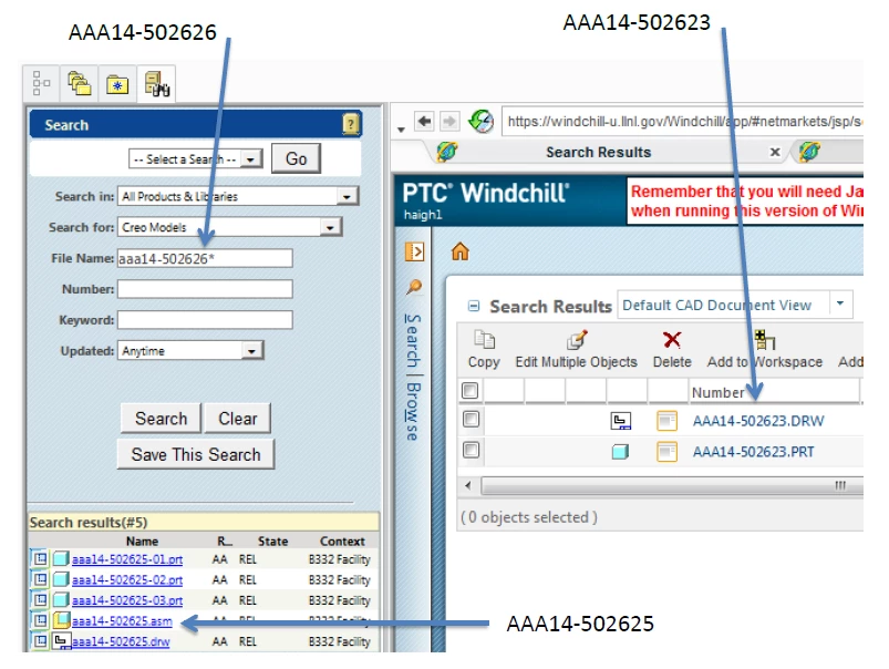

I'd go with m120. I have a couple guys testing m130, and with PDMlink 10.2 the model tree search tool isn't updating the results correctly.
This shows the results of three searches. In the embedded browser is one of the previous searches. The filename was changed and the user pressed enter on the keyboard. that results show in the search results on the left. Then the number was changed again and the user pressed enter. Now there are the results of two previous and the current search. If you press the search button several times they all update to the current search result.
