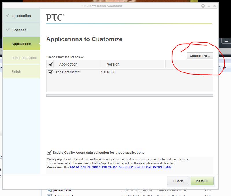

What you need to do is reconfigure your install of creo. Go to the ptc directory in program files then select Creo2.0 then select parameteric then select bin. at the bottom should be reconfigure.exe and selct that. It brings up the install screens again. you just next through the first couple until you get to the following

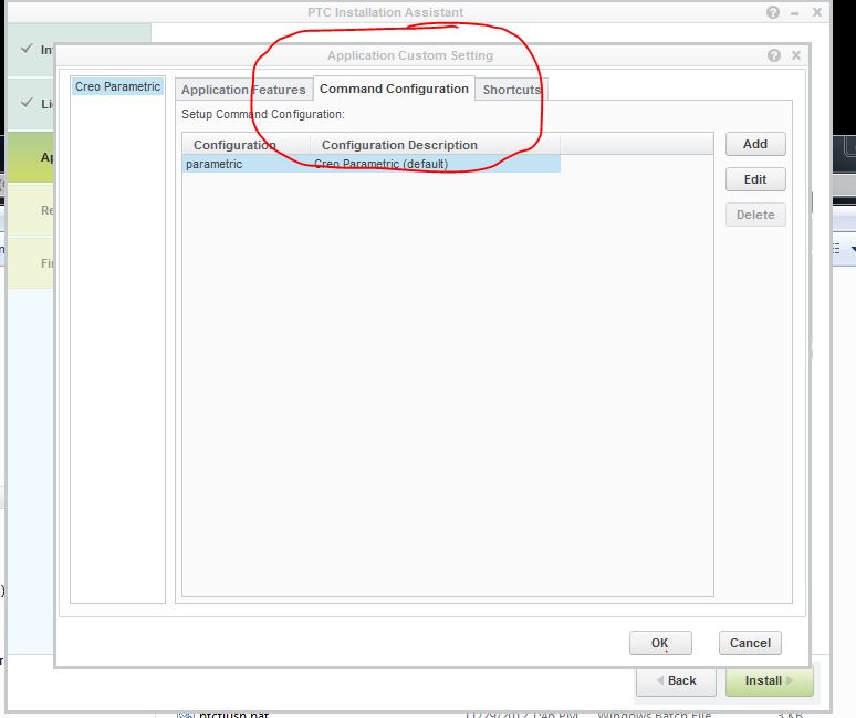

Then you select the customize button at the top. Then select command configuration and edit the existing.

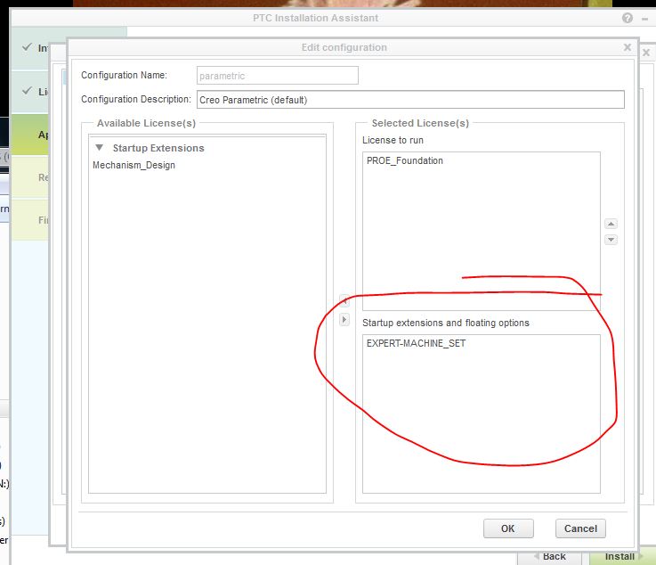

The Machine set will be on the left side with mechanism design. If you drag that to the right side
where mine is and say ok and go through the install again it should load every time with the machining active so you won't have to select the license every time. you don't need to reload all the software just let it reconfigure it. it should ask if you want to reload or just reconfigure.

Hi Steve
Thanks for that, I now have it sorted.
Thank you
