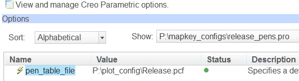

It doesn't appear as though Creo is paying attention to my pen table file when exporting to pdf.
The config editor shows that the config option is loaded:
[cid:image001.png@01CDDF8A.C47E60F0]

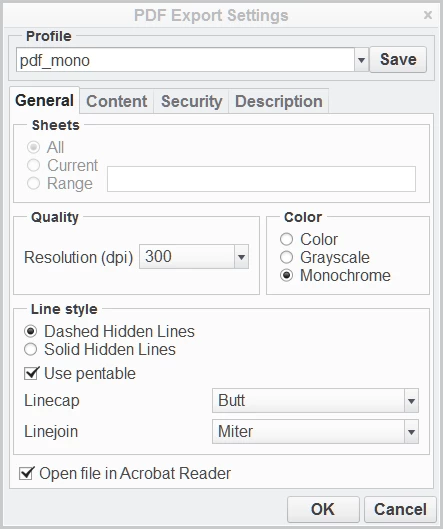

And I have use pen table checked in the setup dialog:
[cid:image002.png@01CDDF8A.C47E60F0]
But the line weights in the pen table file are ignored.
One other question. Anyone know where a saved profile is saved to? Notice in the screen shot above pdf_mono is the profile I saved.

Ah, found my own problem. The config that I loaded to reset the pen table file was loading the pcf file instead.

Found them, they were in my start in directory. The file extension is .dop
Doing a search on ptc.com I found this document that says:
The content of the file looks like this:
