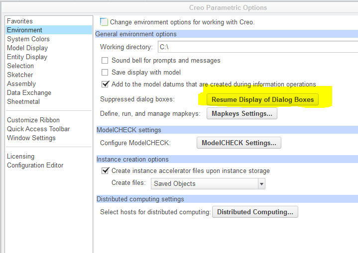

You can see if this helps:
Feb 19, 2015 7:49 AM UTC
