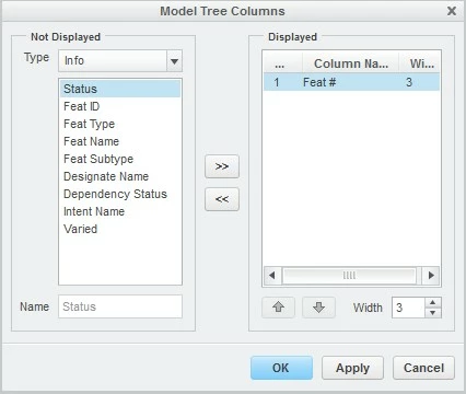

I thought I'd clarify what I'm talking about. Thanks to all who have replied. I probably wasn't clear enough. I'm attaching images to show what I'm experiencing.
[cid:image006.jpg@01CD5A86.729AD680]
See how the feature number column comes in at the center of the model tree? It's only supposed to be three characters wide.
[cid:image007.jpg@01CD5A86.729AD680]
And this is how the model tree arranged, and yes I have a tree.cfg file saved with this set up.
I want to know if I can either set feature number column to the right side of the screen. When it's set to take three characters, but yet eat up half of the model tree window, it's annoying.
Again, not a show stopper, but a minor annoyance.

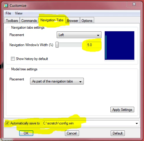

I guess this has been beaten to death ….. but …… I don’t know if anyone mentioned as an adjunct ..
Tools >> customize screen …
[cid:image008.png@01CD5EBC.0D6A1110]
Or smaller than 5 and when it saves to config.win …….. presto. I mean if you don’t really care where the splitter bar is and just want to reclaim window space you don’t even need the map key ( tho I use one in conjunction).
