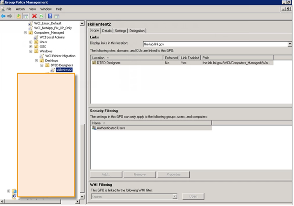

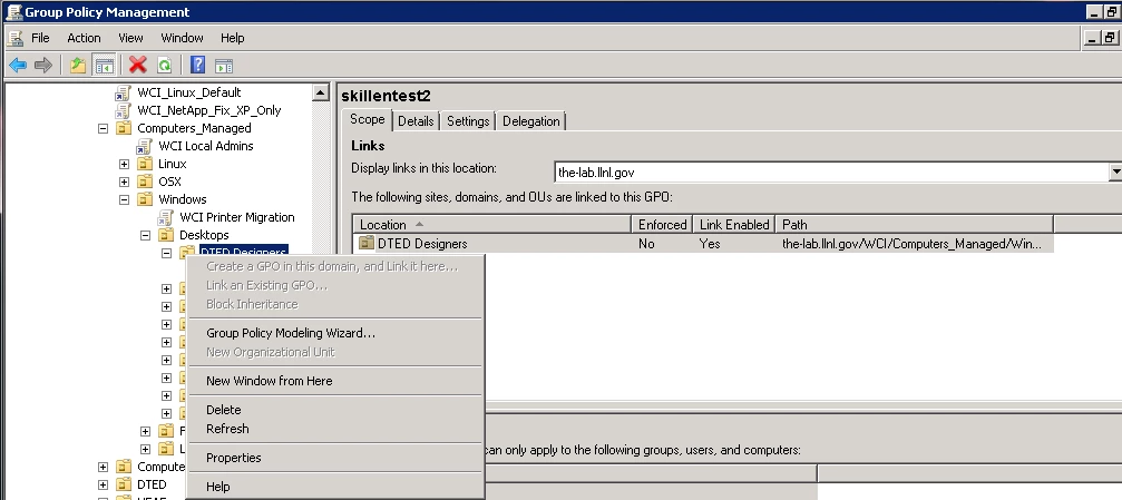

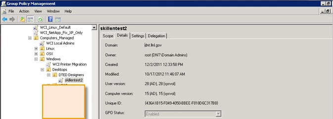

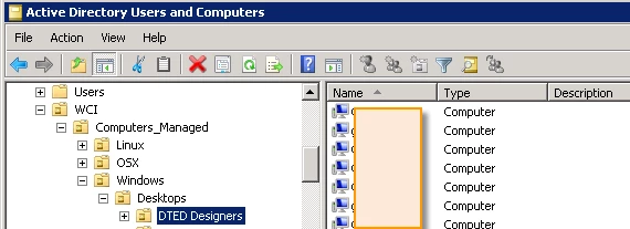

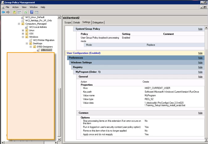

Our IT guys used the Group Policy Manager to run the silent installer script I developed when the users in a group rebooted their machines. It’s set to only run once.
