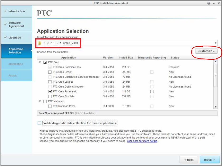

Bonjour,
je dispose d'un CREO 2 en anglais, je souhaiterais le passer en Français.
Pouvez vous m'aider ?
Merci d'avance.
cdl
Fabrice
Best answer by MartinHanak
by default Creo is installed in English, only. If you need to install additional language (for example French), you have to click Customize button and check language box.
Creo is taking regional settings from Windows. If you are using French environment, then Creo will start in French as soon as French language is installed.
MH
February 10, 2017
MH

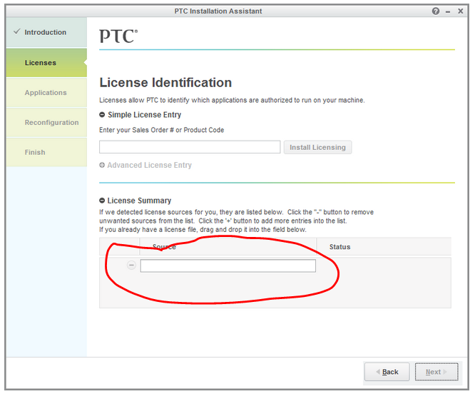

February 13, 2017
Hi and thank you Martin, but the problem is that next : I am stuck and can not go further.
Fabrice.
February 13, 2017
I hope you did not removed your english installation. Go to CR2_loadpoint\Creo 2.0\Parametric\bin directory, locate parametric.psf file and open it in Notepad.
Path to license is defined on line beginning with ENV=PTC_D_LICENSE_FILE-=blablabla
During new installation, put blablabla put into Source field.
