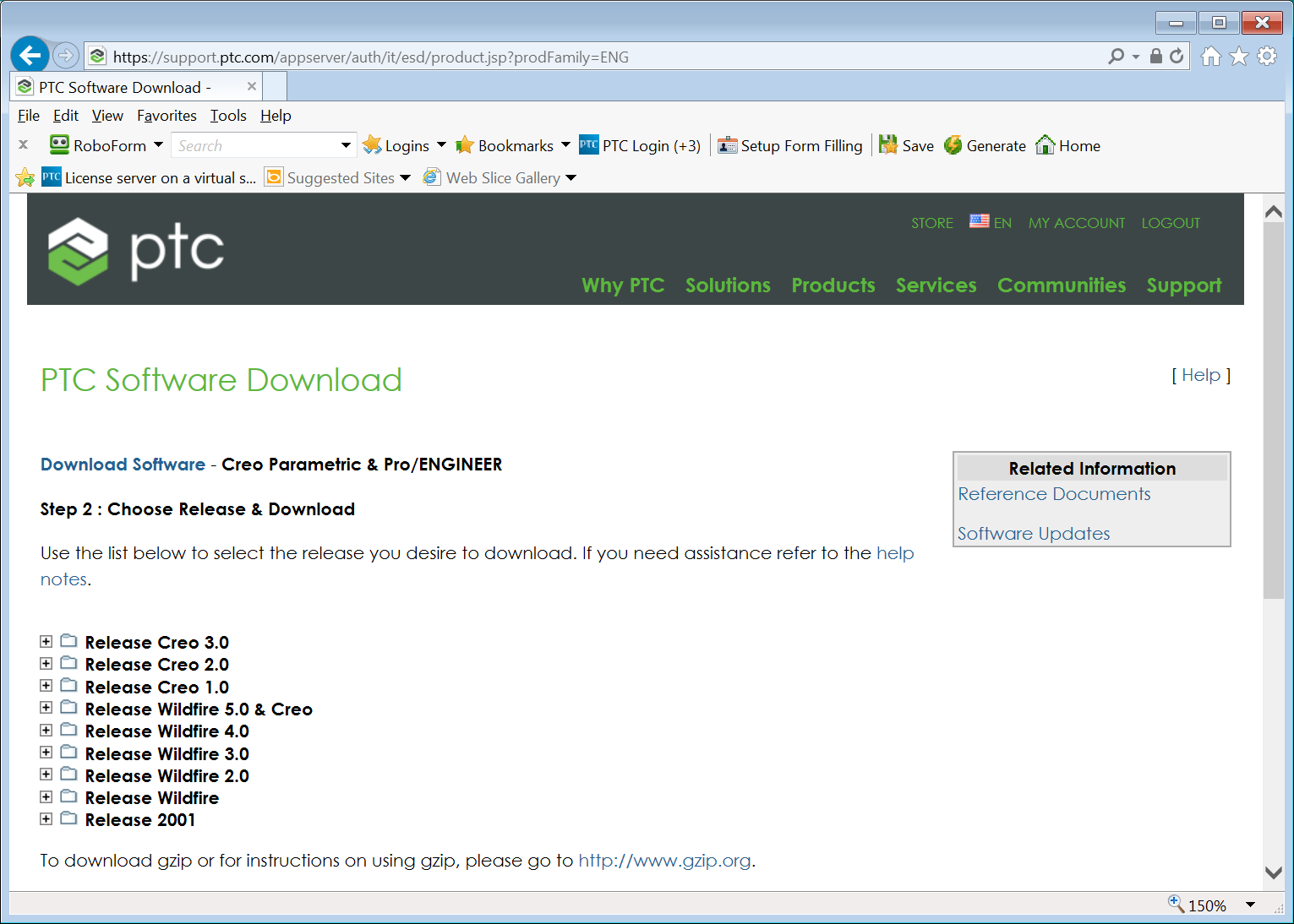

go to https://support.ptc.com/appserver/auth/it/esd/product.jsp?prodFamily=ENG
and log in to PTC Support.
You will see following page:

Log in to PTC.com support and go to the software download page.
https://support.ptc.com/appserver/cs/software_update/swupdate.jsp
