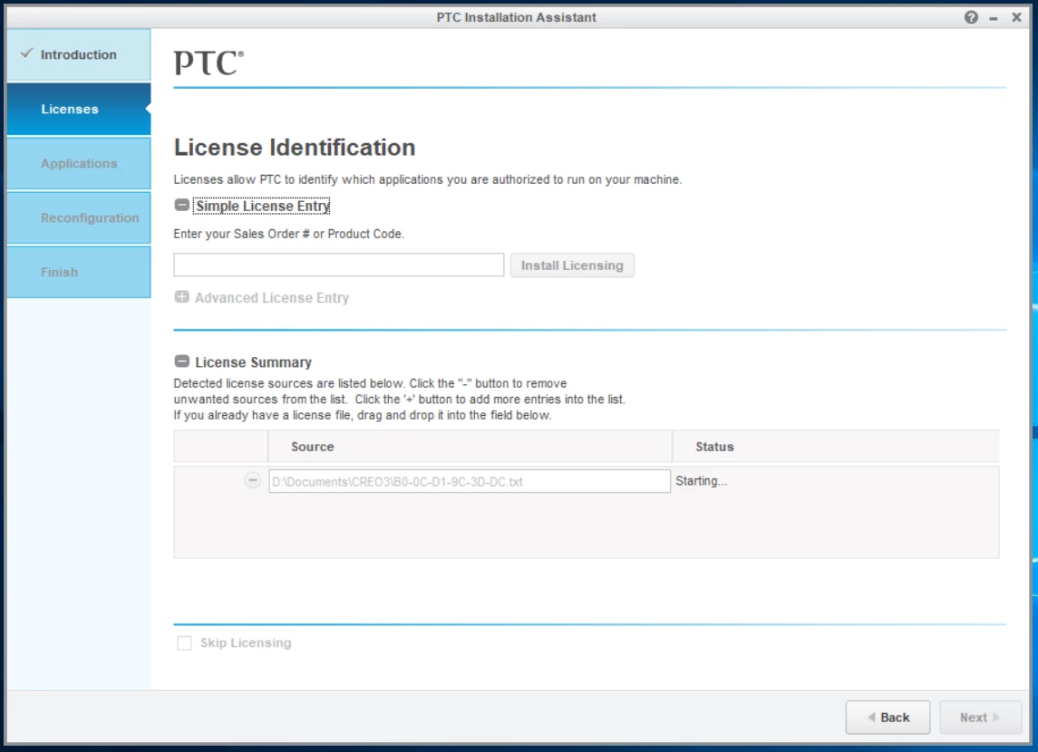

    I switched to a new machine and to win10. I cant load my academic license the way I used to. I skipped licensing at installation, and now I want to do it. On windows 7 this way perfectly worked:
    C:\Program Files\PTC\Creo 3.0\M100\Parametric\bin --> reconfigure --> licenses --> drag and drop license
    Now as I drag and drop the license, first the window goes gray and nothing happens. If I click on back and try again, it says "starting...", then nothing happens again. It doesent even says that the license is unrechable or smething.
