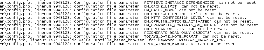

StephenW
December 7, 2016
Every time you launch creo, it creates a STD.OUT file in the start-in folder. That text file tells you config.pro errors and other useful info for diagnosing some of the option errors.
mperkins1-VisitorAuthor
December 7, 2016
I learned something today! Thanks a ton for letting me know about this.
