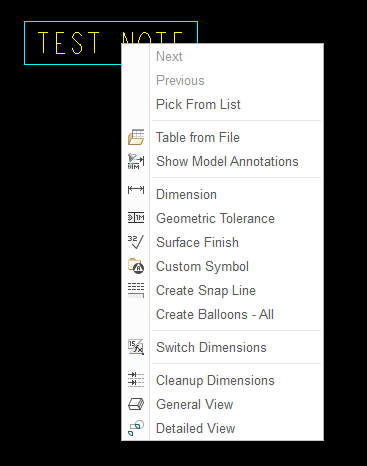

When in the Annotate Tab, I right click on text, I don't get the options you show..
StephenW
Jul 22, 2016 3:18 PM UTC
You have to select it and then right click, provided you are on M100.
I can tell by the blue outline, you haven't selected the text, you are just hovering over it.
