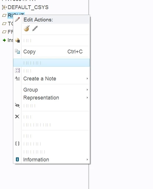

Hello.
I need help.
Below picture is problem.
I've reinstalled it, but it's still in its current state.

solution no.1
Add following options into config.pro file:
DIALOG_TRANSLATION no
HELP_TRANSLATION no
MSG_TRANSLATION no
MENU_TRANSLATION no
solution no.2
Add following line at the end of parametric.psf file:
ENV=PRO_LANG=english

June 22, 2018
You may try reinstalling Creo 3.0 (after disabling Firewall/Anti-Virus) OR if you have any other machine with same version and datecode installed, compare the installation directory. If something missing copy from working machine to affected machine.
