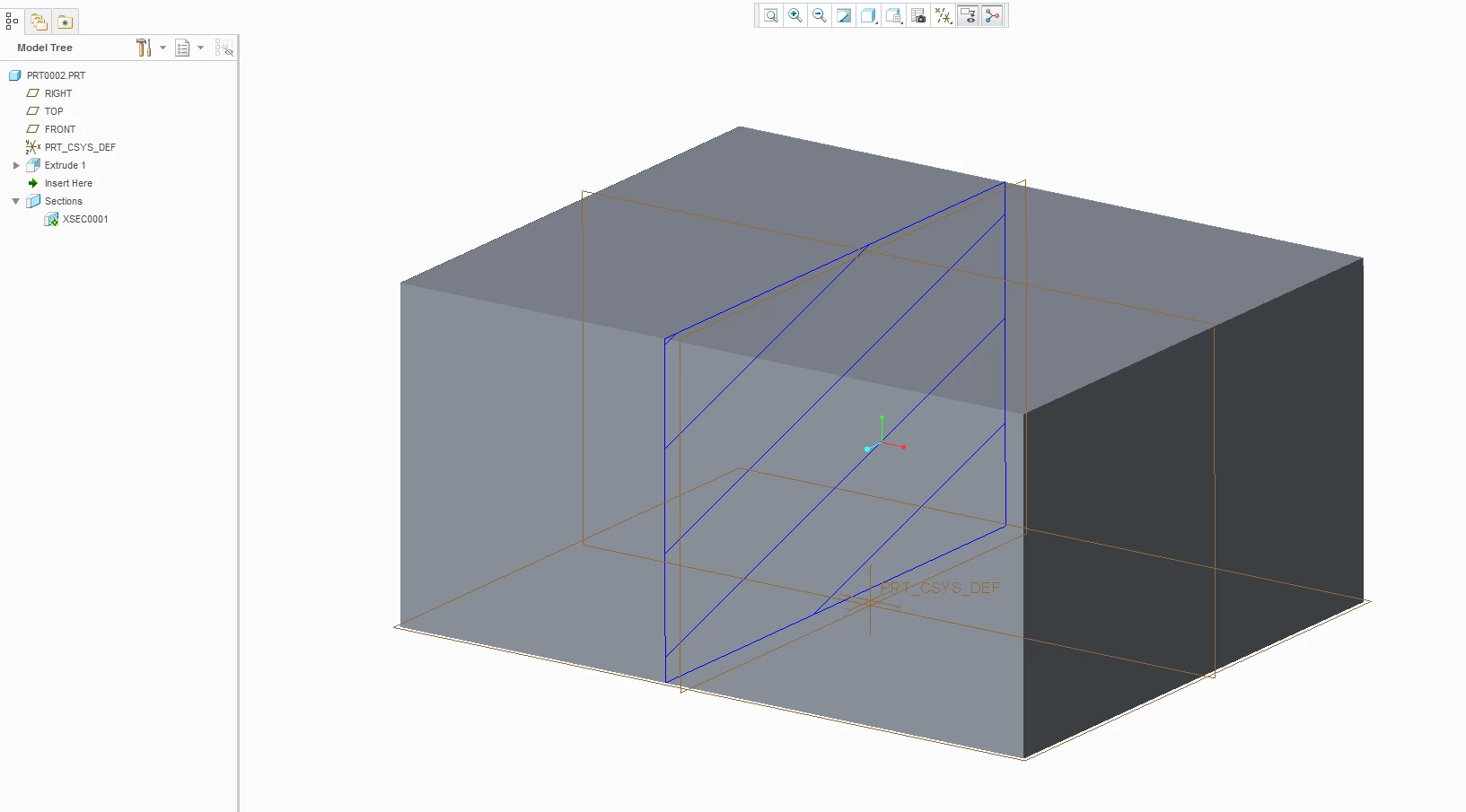

Hey All,
I am working with a model where I need to show cross sections. However, when I use the section tool, I can place the cut plane where I need it, but the material is not removed. When I do this in an assembly, then the parts that are completely behind plane will be removed (as they should), but any parts bisected by the cut plane stays in view and isn't clipped.
Steps I've taken:
I have checked this with the same components on my coworker's computer and it works normally (the parts are clipped).
I have reinstalled Creo
I have reverted to the default config.pro file.
It doesn't just do this in assembly, but also does it for a single part. (see attached picture)
Any help or suggestions would be appreciated!

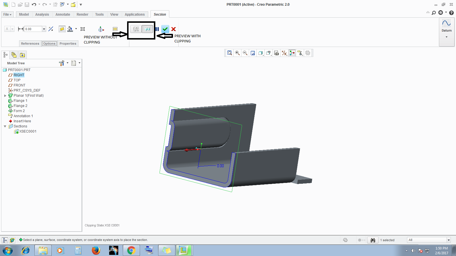

Hello Thomas,
I am sure you would have done but it is not a harm to ask. Have you tried previewing you part with clipping mode as shown in pic belowcross-section.pngPreview without clipping mode.png

February 6, 2017
Thanks Stephen! Yeah, my graphics card drivers were out of date. I had no idea as everything else on the computer behaved normally! Thanks for your input!
