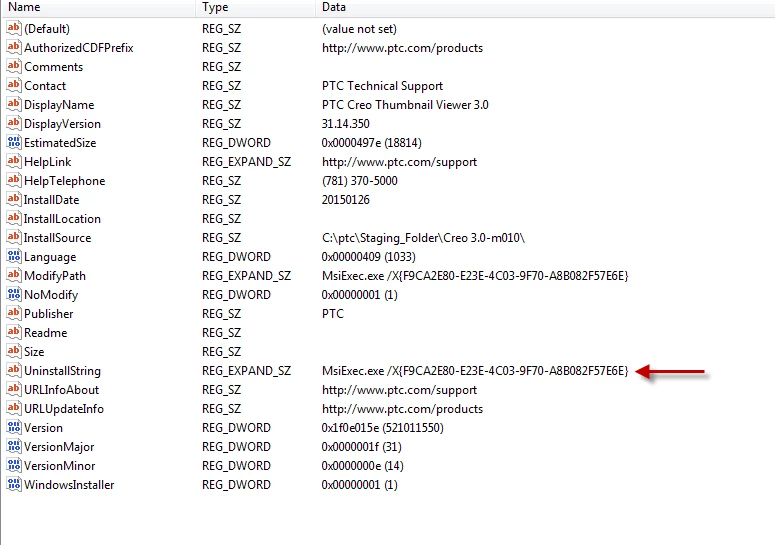

davehaigh13-AquamarineAuthor
Jan 29, 2015 6:07 PM UTC
I looked in the registry.
[cid:image001.png@01D03BA2.F70476B0]
I found this. I assume you’re saying if I just enter this uninstall string it will do the uninstall without having to get the GUID?
By the way what’s a GUID?

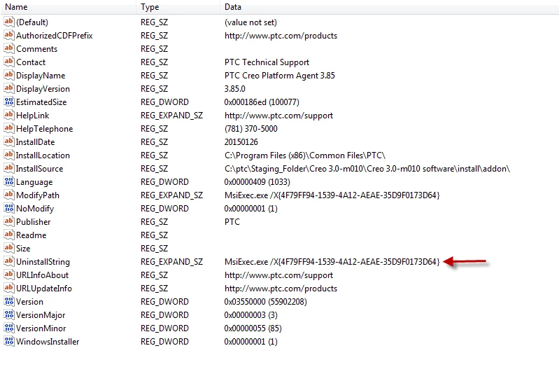

Jan 29, 2015 6:19 PM UTC
FYI the creo agent is in a different path in the registry.
It’s here with the 32 bit software:
HKEY_LOCAL_MACHINE\SOFTWARE\WOW6432Node\Microsoft\Windows\CurrentVersion\Uninstall
The thumbviewer is here with the 64bit software:
HKEY_LOCAL_MACHINE\SOFTWARE\Microsoft\Windows\CurrentVersion\Uninstall
