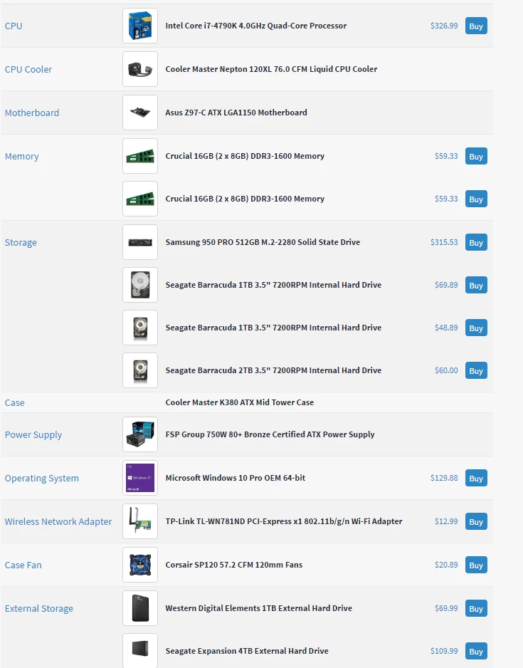

I am running Creo 3.0 M070 on a student license on Windows 10 Pro, my PC details are attached in an image (not sure how to share PC part picker builds)
The OS and Creo are both installed on the Samsung 950 Pro, I don't have any other OS
Does anyone have any suggestions, because having to do CAD on my laptop is no fun!

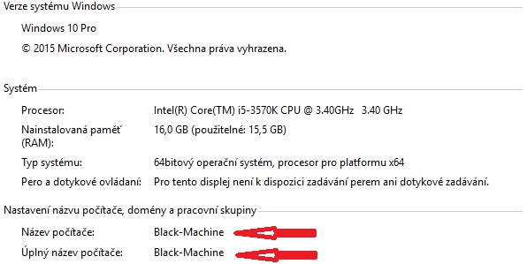

You would not happen in the computer name diacritics?
tward1-VisitorAuthor
Jul 18, 2016 7:19 PM UTC
Sorry I'm not sure I understand your suggestion?
Jul 18, 2016 8:48 PM UTC

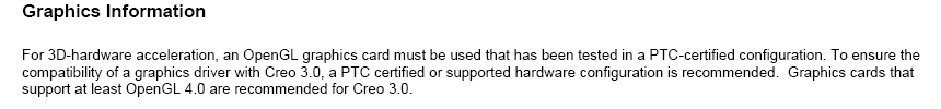

Jul 18, 2016 3:11 PM UTC
Did you check to see if your video card supports OpenGL 4.0?
Jul 18, 2016 7:21 PM UTC
My graphics card supports open GL 4.4 and I have been running Creo 3.0 one the computer pretty much since its release.
