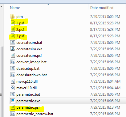

Hi All,
I have 4 different .PSF configurations files to start Creo 3.  Each PSF file is going to different licenses and activating some floating modules.
When setting up the PSF files is there a way to show a default on top of the list or arrange the order of the PSF files when starting Creo 3?
Thank you.

I just tested this.  It most definitely IS based on the PSF filename.

I'd have to double check, but I'm 99% sure it's based on the actual filename of the PSFs sorted alphabetically or numerically.  Try simply renaming the PSF files.

I did try that already. I renamed 1-<name> then a-<name>.  If alphabetic then in my list Nvidia Creo Parametric or Nvidia Creo Parametric Advance should be first.
