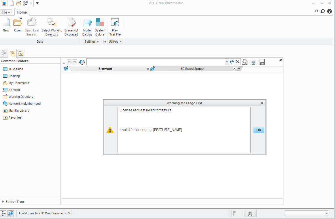

I have problem with Creo 3.0. When I run Creo, it shows a warning message with:
License request failed for feature
Invalid feature name: [FEATURE NAME]
Next I click "OK" and application shut down.
I found similary topic on this support, but advices in this topic donť work.
Do you have some tips for fix my problem?

    Seems when you were installing Creo 3.0, you used the option Skip Licensing to define license server or license file.
    To correct this, you need to reconfigure Creo 3.0 and define the license information.
    1. Run reconfigure Creo 3.0 by executing reconfigure.exe from Creo 3.0 installation\parametric\bin
    2. Under License Summary define the server name as 7788@server_name (for license from server) OR license file path for locked license > Install.

    Feb 27, 2025 7:17 PM UTC
    It worked
