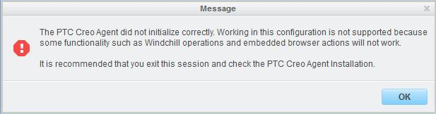

For those who may be configuring Creo 3 to run from a network installation, you will quickly discover that the Creo Platform Agent fails to start if you install to a network location (or install locally and copy to a network location). After extensive testing and working with PTC technical support, it turns out that there was a (previously) undocumented environment variable that needs to be set:
CREO_AGENT_EXE_PATH
This is now documented in CS104032.
Failure to set this will lead to the following messages:

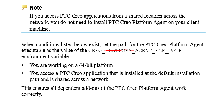

I came across this setting in the latest PTC Creo 3.0 Installation and Administration Guide (M060) and couldn't get it to work.  There were two problems in the documentation, which your post here handily resolved:
  1. The environment variable seems to be incorrect in the documentation (they specify CREO_PLATFORM_AGENT_EXE_PATH, not CREO_AGENT_EXE_PATH)
  2. It wasn't clear whether the name of the executable should be included in the path or not.  It should.
