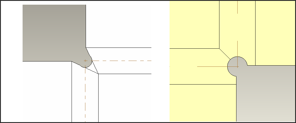

Recently updated to Creo3 and am having some problems creating a circular corner relief. See below: It seems to be placing a circular relief over the top of the standard "No relief" instead of replacing it. Is there a config. setting that I'm missing someplace? Thanks.

To be more clear,in this example, the part on the right is Creo 2. The part on the left is the same part in Creo 3. Why is the corner being treated differently?

This needs to be reported.
No promise something will get done when a version does something differently, but -please- report it in a support case.
If you cannot create a support case, maybe someone here is willing to report it if you post the files.
