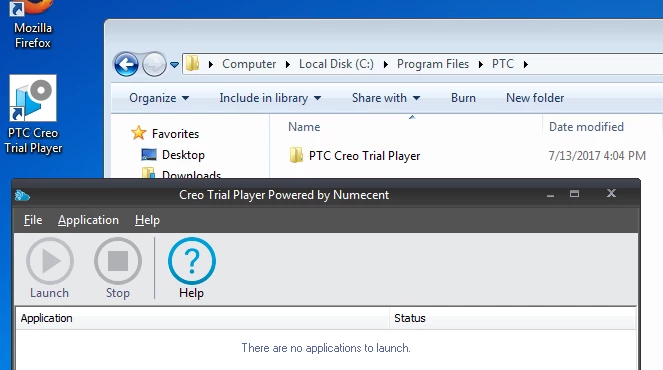

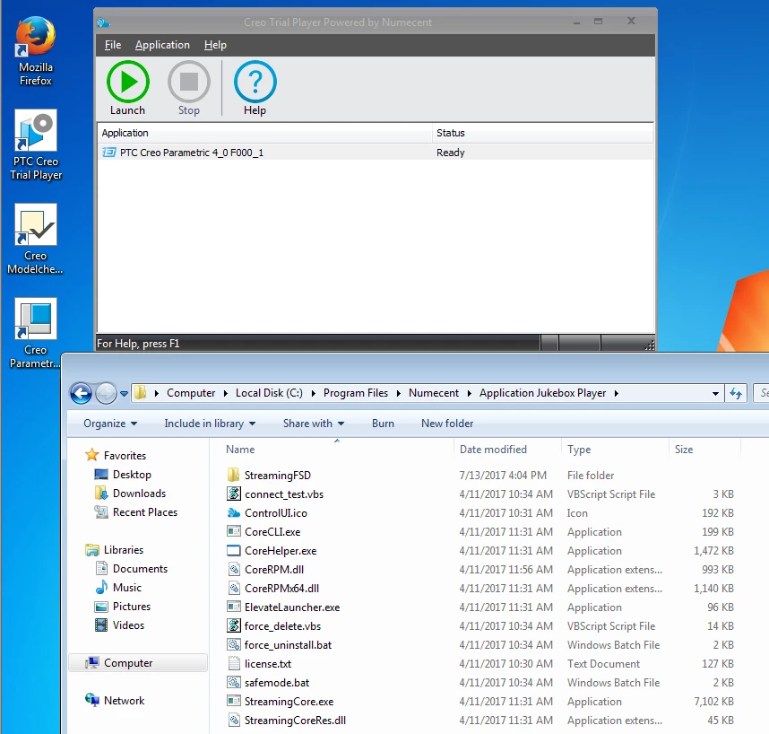

Hi Martin,
during installation of Creo4.0, an additional software is also installed - "PTC Trail Player Powered by Numecent" (screen1.png). It acts as "virtual machine" - when you shut it down, you are not able to start Creo. What is more - shortcuts disappears form Public Desctop.
Creo4.0 in stored in default folder (screen2.png), and of course contains *.psf file. Strange thing is that license_file (C:\Windows\numecent_trial.txt) pointed in *.psf could not be found. Of course I've marked to show all system/hidden files in directory.
If you log as non-admin user Creo4.0 folder disappears (screen3.png), and Creo Trial Player is empty.
I understand that it could sound as science fiction, but it is true. When one of my customer inforned my about it - I did not believe him. But after making attempt by my own - I have to addmit that he is right.
