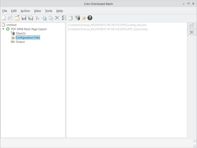

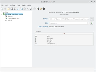

Creo 4.0 Distributed Batch won't go beyond status "Unsubmitted"
I am trying to batch convert drw to pdf. I have set the pro_lang=English as suggested by some threads. I have created a config.pro with search paths pointing to the parts of which drawings are to be converted to pdf. However, when I run distributed batch it does not runs, instead it gets stucked at "Unsubmitted" stage. The status colors are all yellow. Even if I stop the process it does not stops, rather I have to force close. I have reconfigured the creo to use creo distributed batch. Tried even from ptcdbatch.bat file. But of no use. Please help me as I need to batch convert more than 300 drawings and would take ages to do that.

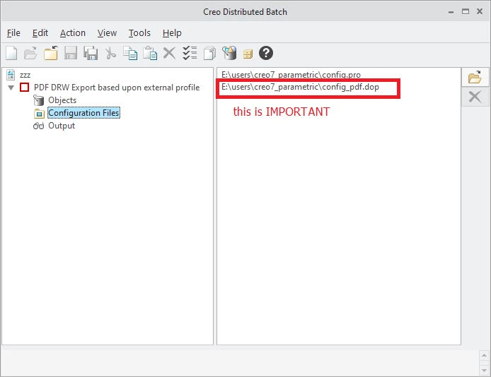

please read following documents
https://www.ptc.com/en/support/article/CS60575
https://www.ptc.com/en/support/article/CS325222
I tested PDF export in Creo 7.0 successfully.
ptcdbatch.bat
I started Creo, opened some drawing and in PTD export dialog I clicked Options button and saved config_pdf.dop file (it contains PDF Export profile).
I started ptcdbatch.bat and defined PDF export batch and start it
IMPORTANT NOTE:
By default ptcdbatch.bat uses following files located in Parametric\bin subdirectory
parametric.bat
parametric.exe
parametric.psf

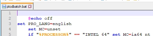

@MartinHanak , I followed the process as mentioned by you in the above steps, but still the issue persists.
Check the configuration files:
Also, I have edited the batch file for ptcdbatch.bat as suggested by you (adding indentations accordingly).
Is there any way how can I check the backend process, where exactly it is getting stuck, so that I can post the issue to this thread.
June 17, 2023
path to files contain spaces. This can cause problems. Place files to different directory and test export again.
