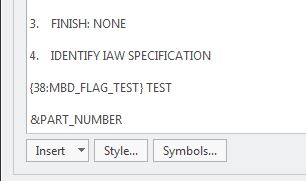

Creo 4.0 M010 - Syntax in 3D Flat to screen notes
Is anyone else experiencing instability when it comes to the on screen text editor in a 3D environment? Any ideas? Tips?
The middle picture produced both the top and bottom pictures - the difference being arbitrary clicking.

    Driver 9.18.13.4112 was causing this issue. Updating to 21.21.13.7735 was the fix.
    bboman1-VisitorAuthor
    June 12, 2017
    This looks to be related to specific version of the K4100M driver. I will post more data as it develops.
    bboman1-VisitorAuthorAnswer
    June 13, 2017
